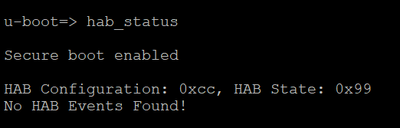

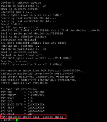

Refer to the picture below. This srg-imx8mplus platform has started secure boot, and Authenticate kernel image fail. Please check message after booting. I think the uboot authentication is passed.
Just to load kernel image failed.
I found out that setp3 is not needed . I want to know if imx8mplus secure boot only choose
verify u-boot signed image. Is this OK ?
Is it necessary to verify kernel and rootfs images?

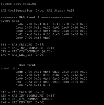

t2865k5
Dear NXP ,
I think uboot image authentication is passed .Kernel image authentication is failed.

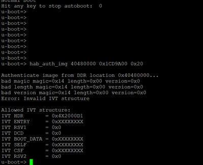

t2865k5
Dear NXP ,
It enter u-boot mode when the device boot . Run command as follows:
hab_auth_img 0x40480000 0x1CD9A00 0x20
14,740件の閲覧回数
smithcoba
It seems the 3rd parameter ivt offset 0x20 is wrong.
you can add debug information here to make sure all the parameters match your wish.
u-boot/arch/arm/mach-imx/hab.c
int authenticate_image(u32 ddr_start, u32 raw_image_size)
u32 ivt_offset;
size_t bytes;
ivt_offset = (raw_image_size + ALIGN_SIZE - 1) &
~(ALIGN_SIZE - 1);
bytes = ivt_offset + IVT_SIZE + CSF_PAD_SIZE;
return imx_hab_authenticate_image(ddr_start, bytes, ivt_offset);

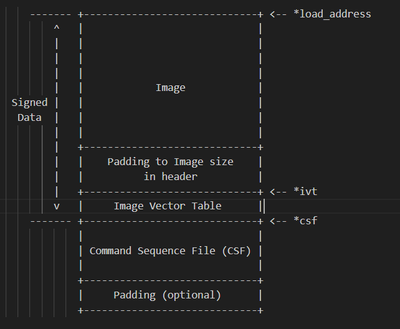

Harvey021
Hi @t2865k5
I want to know if imx8mplus secure boot only choose verify u-boot signed image. Is this OK ? Is it necessary to verify kernel and rootfs images?
Ans: Mostly depends on your need; I'd recommend sign kernel too.
To the error of additional singing, would suggest to check if you've padded kernel as step: 3.1 Padding the image (uboot-imx/doc/imx/habv4/guides/mx8m_secure_boot.txt at lf_v2022.04 · nxp-imx/uboot-imx · GitHub) and better check again the signing image including ivt.

t2865k5
Dear NXP ,
Please refer to the csf_additional_images.txt.
cd cst-3.1.0/csf/
../linux64/bin/cst --i csf_additional_images.txt --o csf_kernel.bin
cat Image_pad_ivt.bin csf_kernel.bin > Image_signed
copy uboot , kernel image and imx8mp-evk.dtb to SD card .
 I get some error log when imx8mplus boot . Please refer to the picture .
 Please help to me to fix this issue .
