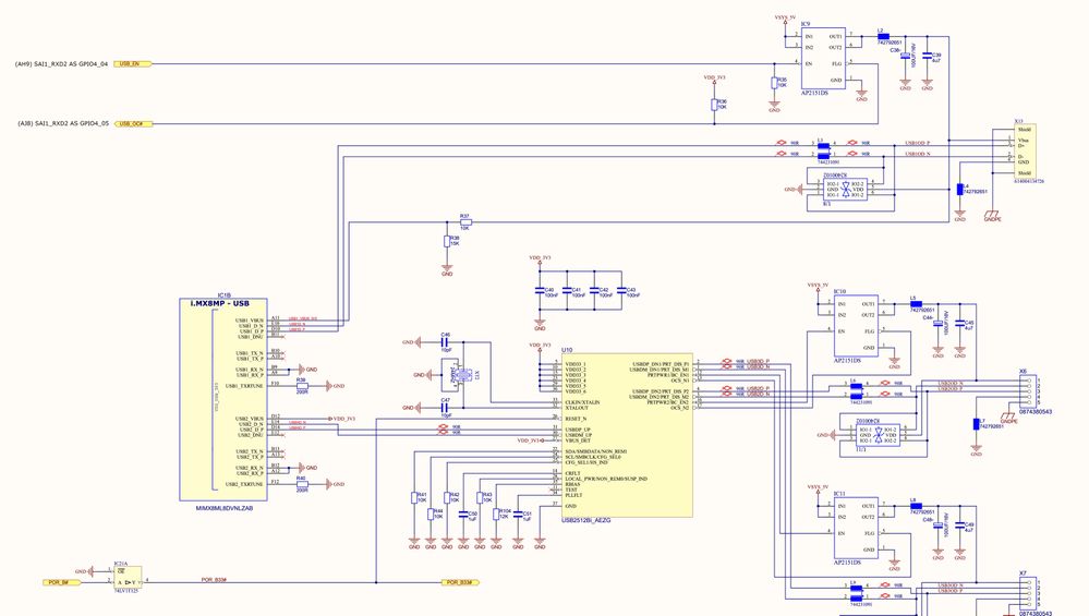

After starting using kernel6.6 we are unable to detect anything connected to the usb1 pins. Our board based on i.MX8MP has 2 hosts. One on usb1 and other on usb2.
Short description about attached scheme:
- usb1 pins directly connected to the usb "A" female connector (x13)
- usb2 pins connected to the hub ic (u10 usb2512) and then to the 2 more usb "a" female connectors (x6, x7)
- usb1_vbus comes from the power regulator (ap2151), the enable signal of the regulator drives by SAI1_RXD2__GPIO4_IO04 pin
- usb2_vbus always connected to the 3.3v
The device tree uses imx8mp.dtsi include. Bindings for the usb0(1) are:

The main problem:
Nothing detects on X13 (usb1), but the any devices (usb flashes, mouses, keyboards, touchscreens) connected to the X6 or X7 detects well and always.

The same things works well with kernel 5.15.
What i have to change to get the host on usb1 up and running and able to detect connected usb mass storage device/usb flash?

osipovvo
Adding "regulator-always-on;" to the regulator section and using default kernel config without modification solves the issue. Like a crutch/trick/workaround.
