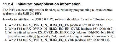

Currently USB2 (high speed) is working but USB3 (super speed) is not working. I think USB3 PHY is not working correctly. I found below in the IMX8MPRM document section 11.3.2.9 Fixed RX Equalization.
The PHY can be configured for fixed equalization by
programming relevant control registers in the USB 3.0 femtoPHY as follows.
1. Write 1'b0 to RX_OVRD_IN_HI.RX_EQ_EN [address 16'h1006: bit 6].
2. Write 1'b1 to RX_OVRD_IN_HI.RX_EQ_EN_OVRD [address 16'h1006: bit 7].
3. Write a fixed value to RX_OVRD_IN_HI.RX_EQ [address 16'h1006: bits 8–10]
[equalization setting] (generally 2–4, based on testing in customer environment).
4. Write 1'b1 to RX_OVRD_IN_HI.RX_EQ_OVRD [address 16'h1006: bit 11].
The RX_OVRD_IN_HI is a PHY internal register and accessed through the register in
the USB controller. See PHY Register Control (PHY_CRCTL) in the Universal Serial
Bus Controller (USB) chapter for details of how to update a USB PHY register. In the
above steps, the register RX_OVRD_IN_HI will be written four times. The software
must also read the RX_OVRD_IN_HI register first and keep other bits the same while
updating specific bits.
I don't know how to access this register. Can you explain where I can find this information?
Do you have any sample code to access this register?

You can check the memory map on the reference manual:
Manuel_Salas_0-1747858947224.pngManuel_Salas_0-1747858947224.pngManuel_Salas_1-1747858957123.pngManuel_Salas_1-1747858957123.png
You can see for USB1 the address is 3810_0000 and offset to RX_OVRD_IN_HI is 1006 as described in chapter 11.2.4 Initialization/application information:
So,
USB1: 0x38101006
USB2: 0x38201006
Salas.

I double check, and there is not a specific memory map register for RX_OVRD_IN_HI because it is a PHY register.
From internal team, you can access to RX_OVRD_IN_HI as below:
# echo 0x1006 > /sys/kernel/debug/phy/phy-382f0040.usb-phy.3/phy-382f0040.usb-phy.3/ctrl_reg_base
# echo 1 > /sys/kernel/debug/phy/phy-382f0040.usb-phy.3/phy-382f0040.usb-phy.3/ctrl_reg_count
# echo 0xB80 > /sys/kernel/debug/phy/phy-382f0040.usb-phy.3/phy-382f0040.usb-phy.3/ctrl_reg_value
# cat /sys/kernel/debug/phy/phy-382f0040.usb-phy.3/phy-382f0040.usb-phy.3/ctrl_reg_value
Control Register 0x1006 value is 0x b80
This is from Linux.
Salas.
