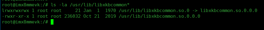

jieh朱
I run weston-touch-calibrator and it will prompt xkbcommon error. Is this the reason that it needs to be calibrated every time it restarts?
How can I remove this error? I see this library under / use /lib /.
15,497 Views

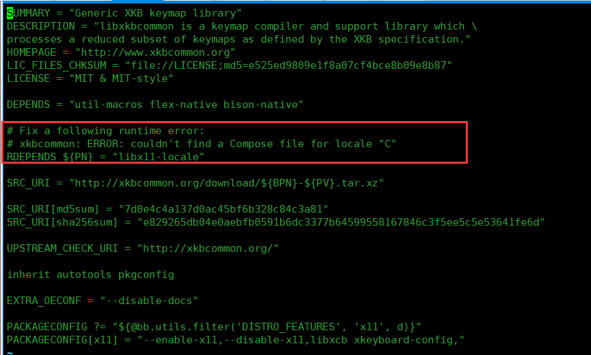

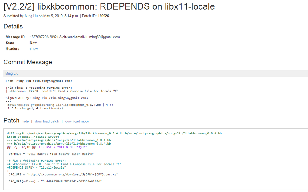

Hello Jiehuai,
    看来你要去修patch了,看这里,把它打上去!
[V2,2/2] libxkbcommon: RDEPENDS on libx11-locale - Patchwork
Have a nice day!
Weidong

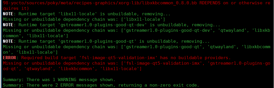

jieh朱
你好!
   我按照这个补丁修改sources/poky/meta/recipes-graphics/xorg-lib/libxkbcommon_0.8.0.bb 添加为如下
   当我修改完运行bitbake fsl-image-qt5-validation-imx进行构建时,他会报如下错误
   我搭建yocto为
repo init -u https://source.codeaurora.org/external/imx/imx-manifest -b imx-linux-sumo -m imx-4.14.98-2.0.0_ga.xml
DISTRO=fsl-imx-wayland MACHINE=imx8mmevk source fsl-setup-release.sh -b imx8mmevk_wayland
15,497 Views
weidong_sun
Hi Jiahuai,
    我的电脑里有4.14.98_2.2.0,和你的环境基本一致,我刚刚测试了一下,没有问题,以下是我的步骤:
1. 和你的方式一样,加入那句话到bb文件。
2.运行命令
# cd imx-yocto-bsp
# source setup-envronment build
# bitbake libxkbcommon -c fetch
# bitbake libxkbcommon -c compile
# bitbake libxkbcommon -c install
# bitbake fsl-image-qt5-validation-imx
没有出现错误
Have a nice day!
Weidong

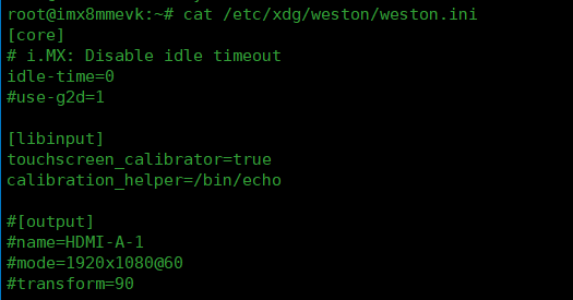

weidong_sun
Hello Jiehuai,
     You should configure weston.ini file.  On it descriptions, see the link, please!
Weston: man/weston.ini.man | Fossies
touchscreen_calibrator=true
calibration_helper=/bin/echo
See above 2 parameters, please!
Have a nice day!

jieh朱
thank you for your reply
I set weston.ini as follows
But his touch restart still needs to be calibrated
