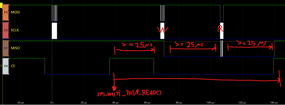

Hi all,
I’m using the SPI interface in master mode from the imx8mm. I’m not so familiar how the Kernel driver will handle a transmission to an SPI slave. The Chip-Select (CS) signal to set or reset the pin takes verry long. Maybe it’s normal, but I not able to explain it. Her is what I see.
spt_write_than_read
When the driver is entered and he start the transmission the function spi_write_then_read() (spi.c) will been called and this function will call function in spi-imx.c. Ok, understood, my question is.
Why dose the CS takes so long to set and reset? I’m not able to explain it or how I can fix this issue. I will send 4 Byte and read 4 Byte via the function.
Device-tree properties and anything else will not help. The 4 CPU’s do nothing else than this test code.
Thanks, for any explanation.

Hi Chavira,
the time slice looks verry good and I would like to have the same result. Is it possible to say which slice is CS, MOSI, MISO and CLK?
I changed a little in the device tree and I'm relative sure that the behaviour is the same, but the result not. Here are the tree settings.

Chavira
Hi @Alex22!
How are you implementing your device tree and drivers?
What BSP are you using?
I will try to use Spidev to have an SPI signals and compare it with your results.
You can consult our driver documentation in chapter 4.3 of our Linux Reference Manual.
