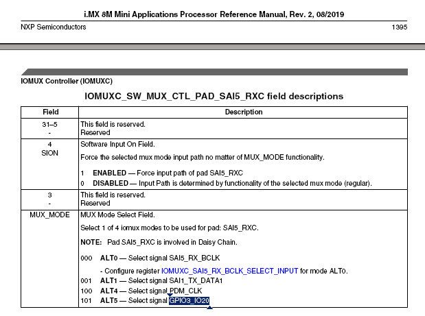

I was trying to setup some pins in uBoot and was trying to find the IO bank and offset mapping so I could make use of
IMX_GPIO_NR(bank, nr) to control the pin.
I didnt see anything in the reference manual and the imx dts files on the kernel side use this format
* The pin function ID is a tuple of
* <mux_reg conf_reg input_reg mux_mode input_val>
Also in the kernel is there a recommended place for board initialization or is it best to keep that in uboot?
Thanks!

In this example
#define USDHC2_CD_GPIO IMX_GPIO_NR(2, 12)
I wanted to know how I could find that bank 2 and offset 12 corresponds to a specific pin.
So for example where can I find the mapping from SAI5_RXC or AC15 to a bank and offset number.
Thanks!

Thanks Igor I found this in uboot and understand how to use the #define.
What I need is a way to map from a named pin for example SAI5_RXC or AC15 to a bank/port and offset number.
Do you know where I can find that?
Raman

igorpadykov
Hi Raman
from p.1395 RM : GPIO3_IO20 (port3, index 20)
