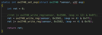

2. In the isp tuning tool, the manual exposure tab always present 0 for the exposure, in a result I can't adjust the exposure time. However I have set the maximum integration time in the driver function and my s_exp function is correctly written. what was wrong with the exposure slider?
3. I was testing the auto exposure function of the ISP. However I found that when I adjusted light intensity, there was only gain value changing, and the exposure time was constant (this exposure value can be set to CMOS without error). please see the following picture. Do you have any idea why the integration time was not changing during AEC control?

joanxie
this is what I got:
 Please check the comment in tuning tool.
“For this demonstration system, the convergence speed of auto exposure is not optimized for low frame rates
(which can occur either due to manual setting or because of low light conditions and enabled AFPS). There is
significant headroom for acceleration of the convergence speed of the Automatic Exposure Control (AEC) software
for products. To avoid flicker, the AEC controls the integration time and gain. If the AEC is disabled and the
integration time is set manually, this may result in flicker. The “Exposure” slider in this dialog shows the current
exposure value, but it cannot be used to manually control the exposure. If the auto exposure mode (Level 3) is
disabled, this slider in this dialog can be used to control the exposure manually.”
So if Auto exposure control is enabled one cannot use manual control to set the parameter in tuning tool. Yes they can set the maximum integration time in the driver function though.

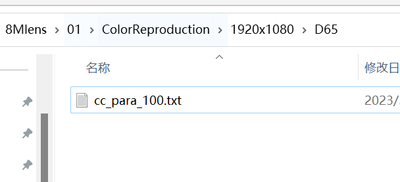

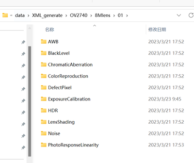

Hello, I encountered a problem with calibration tool XML generator, could you please help me forward it to the technical team?
After I finished all calibrations, I created my OV2740 sensor folders and put in my calibration files (.txt) according to the guideline. When I run the XML generator, the tool returned error with "index exceeds matrix dimensions", please see the following figure. After some experiments I found it was my ColorReproduction files that caused the problem, because when I replaced my ColorReproduction files with the sample OV2775 files, the tool can run normally. I have compared my ColorReproduction file (they were generated by isp calibration tool) with the sample OV2775 file and didn't find any dimension difference. Could you please tell me what's the problem of my generated color calibration files?
10,208 Views
joanxie
What is the resolution setting of the folders name?
10,204 Views
chp0423
I seem to find the problem. The txt files in the ColorReproduction folder must be named to "cc_para_100.txt", like the following figure shows. Other naming will cause the tool returning error
10,198 Views
joanxie
