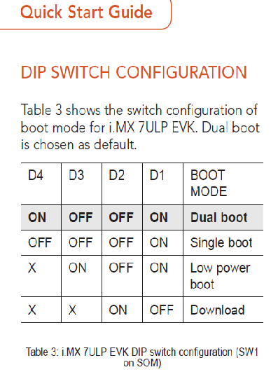

Hi all,
I can't seem to figure out what I am doing wrong here. I have changed the boot-pins to download mode (D1 off, D2 on) but I can't detect anything on my PC.
If I use the SD card provided with the EVK then the linux distro boots fine (when i change back to dual boot settings (on, off, off, on).
Is there something I am missing here? With the imx7d sabre board I had to remove the SD card and then try to boot the system before the serial downloader worked, is there something similar that needs doing here?
I am attempting to load the android demo image from NXP.
Andre

Hi Andre,
The DIP switch configuration that you mentioned are actually correct for Serial Downloader Mode.
The other thing that you need to verify is that you are connecting the board to the PC trough the USB Type-C port (the one from the processor) instead of the micro USB (which is from USB-Serial converter).
Hope this will be useful for you.

Thanks - silly me, I think I didn't have the cable plugged in correctly...
