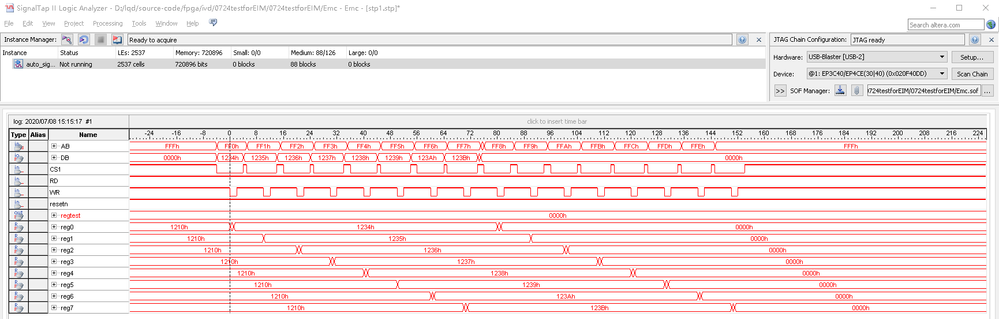

When I use dma to transmit EIM data to FPGA on imx7d, when I write data to EIM bus, some problems occur. My EIM bus data width is configured to 16bit, I write 16 bytes of data to the bus each time:
0x1234 0x1235 0x12346 0x1237 0x1238 0x1239 0x123a 0x123b
My FPGA can receive these 16 bytes of data, but it also receives an additional 16 bytes of 0 data. The 0 data was received because the EIM bus generated 8 more write signals.
Normally, according to the configuration of my data line width, when 16 bytes occur, only 8 write signals need to be generated, but actually 16 write signals are generated. The waveform diagram is as follows:
My dma code configuration is as follows:

I want to know why there are 16 write signals?
At the same time I tried to configure different values for dst_addr_width and src_addr_width, but no matter how I configure it, there will always be redundant write signals. How should I solve this problem?

Hi  其东 刘
for eim burst with dma cases may be useful to look at
sect.9.7.5.4 Burst Clock Divisor (BCD), sect.9.7.5.8 AXI (Master) Bus Cycles Support
i.MX 7Dual Applications Processor Reference Manual
For example sdma source memory address was aligned according to burst size,
PSZ, BL settings in EIM_CSnGCR1 register. First may be useful to test configuration
with barmetal sdk:
rt-thread/eim_test.c at master · RT-Thread/rt-thread · GitHub
igor
