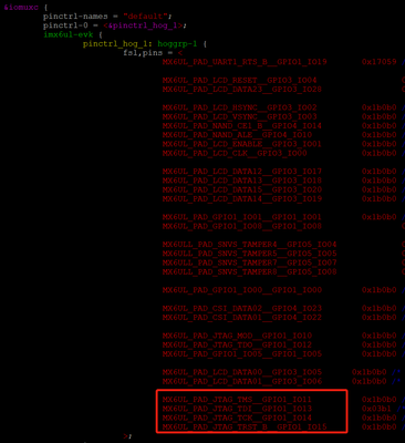

Hello:
        I try to use JTAG_TDI pad as a gpio, but I find that I can't control it's output
        and JTAG_TMS pin as a gpio works well.why?
1,871 Views
riteshmpatel
Hi @chenchenchen,
I hope you are doing well.
In the attached image of Pad IO and control configurations, the 0x03b1 value will be written to the IOMUXC_SW_PAD_CTL_PAD_JTAG_TDI register.
MX6UL_PAD_JTAG_TDI__GPIO1_IO13       0x03b1
0x03b1 value will write to the [9:8] bitfield, which is reserved. One should use the default value 0x1b0b0.
Please apply the below change to dts:
- MX6UL_PAD_JTAG_TDI__GPIO1_IO13 0x03b1
+ MX6UL_PAD_JTAG_TDI__GPIO1_IO13 0x1b0b0
OR
Alternatively, one can configure this value according to one's requirements by referring to Section 32.6.150 SW_PAD_CTL_PAD_JTAG_TDI SW PAD Control in i.MX 6ULL Applications Processor Reference Manual.
Thanks & Regards,
Ritesh M Patel
1,861 Views
chenchenchen
Hello:
      Thanks for your response.
       It is solved.
       I make a mistake to write GPIO5_IOx at devicetree of iomuxc, GPIO_IOx conf reg offset is equal to
      JTAG_XX mux mode reg offset. it is conflict.
