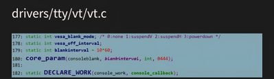

ubuntu 18 run in imx6ull platform always stuck at 10 minutes,  try shutdown suspend can't solve the problem, anyone know how to solve it?

solve this problem by change blankinterval param.

Please try to check it with our BSP, we do not have an official Ubuntu release.

I use the kernel from nxp's  github page,  branches is imx_4.1.15_2.0.0_ga, but nothing change, same stuck at 10 min which can see the message from htop. Any idea about this same situation?
