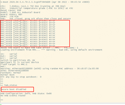

Hi Freescale Team,
There are some problem when I use fuse command to enable secure boot in uboot cmdline with i.MX6 Soc.   My uboot version is 2020.04-5.4.70-2.3.3 .     Look at the picture below
All the fuse prog operations are returned access protect error, this board I used is the first time to enable secure boot ,fuse has never been writen before .    I have no idea what  caused this , have any suggestions?
