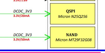

Rita_Wang
MT29F4G01ABAFD can work on the i.MX6ULL. For the nand boot and QSPI boot setting is not the same. For our reference design board we support the nand boot, you can refer to our design, both software and hardware.
9,084 Views
AngelF
Thank you for your help. We checked your reference design, and you support Qspi NOR FLASH and parallel NAND
But this is not our case. We set BOOT_CFG1[7:4] to 0001 becasuse we need to bootup from Qspi. It is working fine if we use a Qspi NOR FLASH for booting, but it does not work if we try to bootup from Qspi NAND FLASH.
We have not found any reference design that boots up from Qspi NAND FLASH and, if possible, we would like to know what changes need to be done comparing to Qspi NOR FLASH.

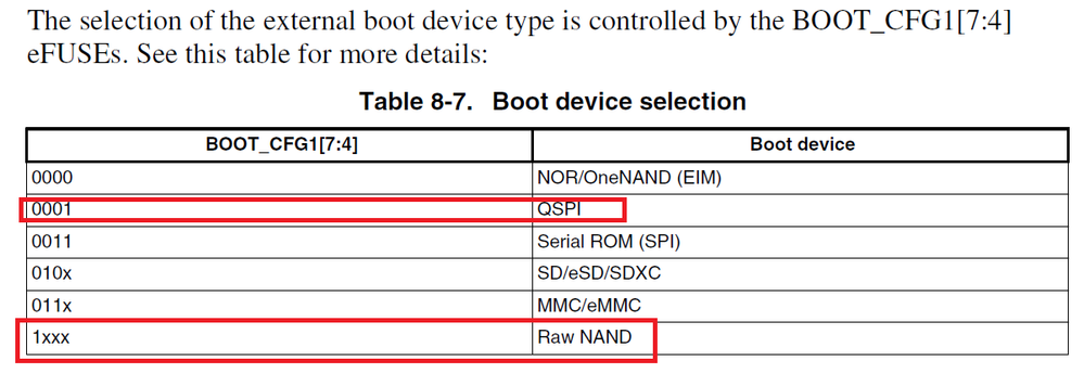

Rita_Wang
Boot mode for the nand you need to change, not the 0001, see the picture I share to you above.

AngelF
I think there is a misunderstanding. Boot mode 0001 is fine because we want to boot from Qspi, we do not want to boot from parallel/raw NAND.
The problem is the memory technology connected to the Qspi. We know that it is possible to boot from Qspi NOR FLASH  and we would like to know if it is also possible to boot from Qspi NAND FALSH.
9,070 Views
Rita_Wang
Here the nand you are using it the Raw Nand, so do not use the QSPI boot mode.
9,046 Views

Rita_Wang
Yes, you can use it.
The boot ROM supports these boot devices:
• NOR flash
• NAND flash
• OneNAND flash
• SD/MMC
• Serial (SPI) NOR flash and EEPROM
• QuadSPI (QSPI) flash
The selection of the external boot device type is controlled by the BOOT_CFG1[7:4]:
