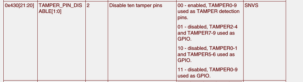

I have examined the TAMPER_PIN_DISABLE fuses via u-boot and it appears that the TAMPER lines should be usable as GPIOs:
=> fuse read 0 3
Reading bank 0:
Word 0x00000003: 7031000c
0x7031000c => '0b111 0000 0011 0001 0000 0000 0000 1100"
From another forum comment:
"Definition of TAMPER_PIN_DISABLE[1:0] are as following :
        00 - enabled, TAMPER0-9 used as TAMPER detection pins.
        01 - disabled TAMPER2-4 and TAMPER7-9 used as GPIO.
        10 - disabled TAMPER0-1 and TAMPER5-6 used as GPIO.
        11 - disabled TAMPER0-9 used as GPIO.
   So, for the mentioned U-boot command, If bit [21:20] is 11, then all the ten tamper pins are programmed to GPIO mode."
Any suggestions as to what I am doing wrong?

ihermida
I am having the same issue. I am trying to set all the tamper as GPIOs without success.
Reading the fuse settings seems to be correct to set it as GPIO assuming that the fuse bank is (0 3).
=> fuse read 0 3
Word 0x00000003: 703100d1
But I can not change the IOMUX to set them as gpios (ALT5).
=> mw.l 0x20e001c 0x5 1
=> mw.l 0x20e0020 0x5 9
=> md.l 0x20e001c 1                              ----------------- TAMPER 0
020e001c: 00000000                               ....
=> md.l 0x20e0020 9                             ------------------ TAMPER 1 to 9
020e0020: 00000000 00000000 00000000 00000000    ................
020e0030: 00000000 00000000 00000000 00000000    ................
020e0040: 00000000
My explanation for that is that the fuse that we are reading is incorrect and should not be (0 3), if not I do not know what I am doing wrong. The HRM says that the fuse address is "0x430[21:20]", page 214.
Can anyone point me to how set all the tamper pins as gpios?

ihermida
Solved. There is no need to configure the IOMUX if the TAMPER_PIN_DISABLE[1:0] fuse is programmed, so you can use them directly as gpios.
For instance, in uboot modify the GPIO5_DR (0x20ac000) and the GPIO5_GDIR(0x20ac004) to play with the data and direction. In that case we use the GPIO5 pins 0 and 9 (10 0000 0001 = 201)
