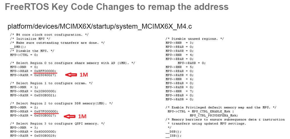

I already have decreased CMA from 14000000 to 14000000/2.
I found the issue: It is because of rpmsg driver static address.
diff --git a/arch/arm/mach-imx/imx_rpmsg.c b/arch/arm/mach-imx/imx_rpmsg.c
index 06a846b..9b58965 100644
--- a/arch/arm/mach-imx/imx_rpmsg.c
+++ b/arch/arm/mach-imx/imx_rpmsg.c
@@ -300,15 +300,15 @@ static int imx_rpmsg_probe(struct platform_device *pdev)
rpdev->vring[1] = res->start + size;
} else {
/* hardcodes here now. */
- rpdev->vring[0] = 0xBFFF0000;
- rpdev->vring[1] = 0xBFFF8000;
+ rpdev->vring[0] = 0x9FFF0000;
+ rpdev->vring[1] = 0x9FFF8000;
} else {
break;
Now, it is not hanging up..

igorpadykov
Hi Rakesh
for rpmsg remapping one can look below:
igor
5,163 Views
rakesh_patel
Senior Contributor I
igorpadykov‌:
Thanks for sharing this. It works well.
