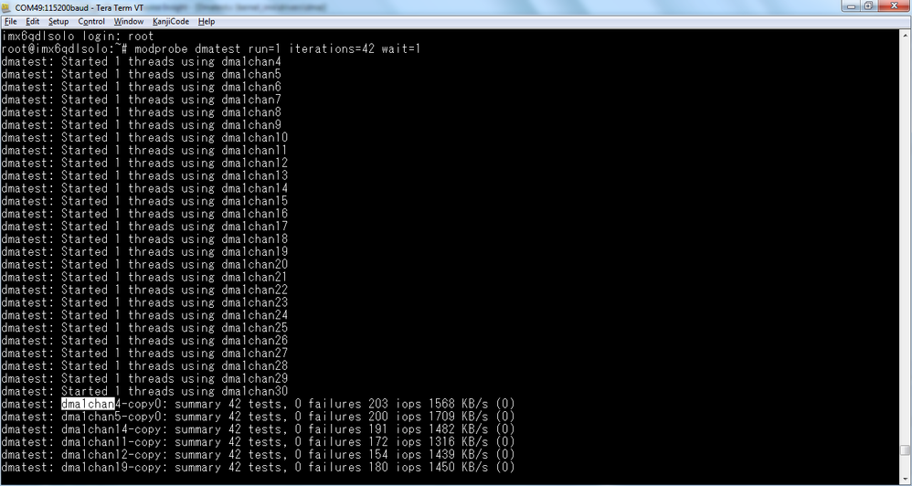

BiyongSUN
The result using the dmatest inside the Linux source tree.
7,202 Views
袁增兴
hi,
Thanks for the support, I am trying to code the multi-thread in user space instead of the dmatest to use the multi-dma-channel concurently, which I found that the dma performance is bad, it is about  42MB/s~44MB/s, which is lower than the cpu memcpy. Can u provide the limit details of the sdma controller?
Best
7,202 Views
