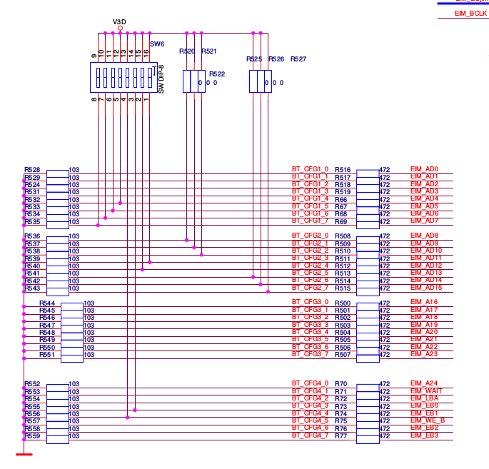

My custom board: reference mx6q_sabreauto  BSP: 4.1.15_1.0.0_ga , I can use mfg boot uboot ,but I use sd boot form uSDHC4 ,it is not work  ,
Bootmode[1:0]   to 10  boot form boart seting
and sw[8-1] to   0100 0011
but it is not work ,
If  there any need to be configured ,please help me ,

and I use
and sw[8-1] to   00111100
boot form spinor  it also not work
2,219 Views

Hi xuhui
for new board it is necessary to run ddr test and find new calibration
settings, change uboot ../mx6sabresd/mx6q_4x_mt41j128.cfg with new
settings and rebuild uboot
i.MX6/7 DDR Stress Test Tool V2.52 | NXP Community
If board still not boots, attach jtag and check boot settings in register
SRC_SBMR1,2. Also please check Chapter 8 Avoiding Board Bring-up Problems
i.MX6 System Development User’s Guide
http://cache.freescale.com/files/32bit/doc/user_guide/IMX6DQ6SDLHDG.pdf
igor

lixuhui112
Hi igor,
Thanks for your reply
my board  can boot use mfgtool  ,  but can not sd and spinor,
