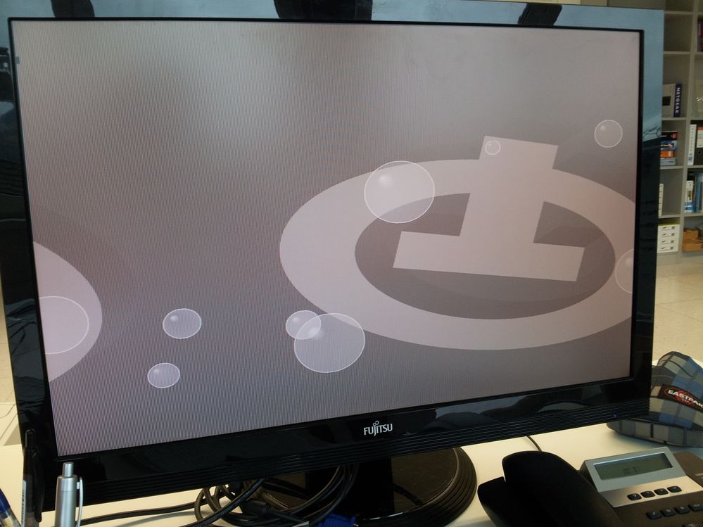

Hi all,
I have an issue every time I try to run GPU. My system is iWave Q7 i.mx6 quad, bsp is based on 4.0.0 from freescale. Basically, I always have the same issue - output image on the HDMI is black/white striped instead of being coloured, with a lot of artefacts. Sometimes it doesn't even start, just makes kernel panic with dumping the stack, starting with the following message:
kernel BUG at arch/arm/mm/dma-mapping.c:478!
Unable to handle kernel NULL pointer dereference at virtual address 00000000
I can observe this with running OpenGL ES 1.1 examples from GPU SDK and also with Qt 4.8 examples (which uses OpenGL ES 2.0). DMA is doing something wrong here and I am not really sure what.
I will post an image of these artefacts a bit later today.
Does anyone have similar issues? How can this be resolved?

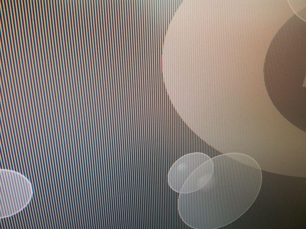

ivankozic
Here are the pictures - basically, everything is vertically striped. It's better seen on the first image. Also, it's not really possible to see or make a photo of but the left part of the image is flickering. So basically, as if there is some misalignment either with pixel format or with DMA. Or both for that matter...
Anyone has a clue?
8,905 Views
ivankozic
I have a small update regarding this issue - in new BSP from iWave r1.4 (based upon freescale 4.1.0), it seems that kernel panic is gone, as I can start all the examples normally. However, stripes are still there. I will try to recompile the gpu code and see if there are changes (as I'm using binaries from previous build). The examples also do not crash, so I guess DMA problem is fixed.
