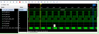

Levear
The previous issue has been resolved, it is due to the FPGA program。There is a new problem, in synchronous mode (Burst len=32), when I write data to addresses 0x50000000 (FPGA corresponding address 0x0000) and 0x50000002 (0x0001) using two variables, as shown in the following figure, the FPGA only grabs an address of 0x0000 and does not have 0x0001. However, when I replace 0x5000002 with 0x50000040, the FPGA can grab an address of 0x0020.

Levear
thank you !  you  are right  .
The official SDK defaults to setting memory to s_ MmuRamAttr, it should be set to s_ MmuBufferAttr, the specific differences are as follows
This way, the CS and RW signals are normal, but there is another issue: reading data is normal, but when writing data, the data received by the FPGA on the data bus is always 0, which is strange?
