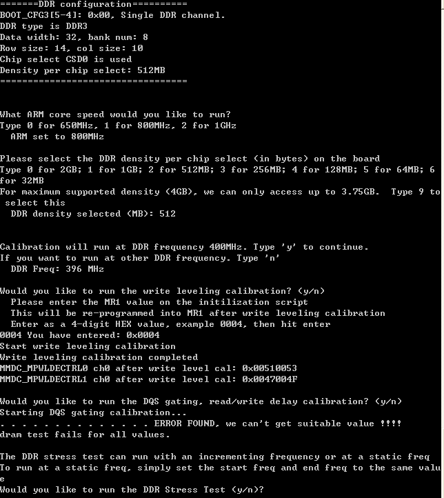

昌清黄
Hi igorpadykov:
          my board memory capacity: 512M.
                         DDR chip: MT41K128M16JT
                         DDR chip total number: 2
                         data bus width: 32
     when excute Read DQS Gating, but system information showed the result failed
what causes this issue?
3,790 Views
igorpadykov
Hi 昌清
if you board runs other memory tests well, you can omit
DQS Gating. In particular this issue may be caused by board noise.
igor

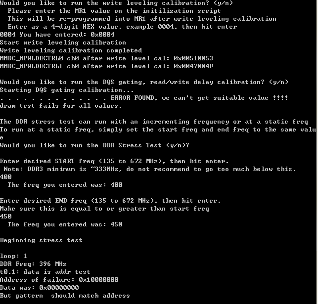

昌清黄
hi igor:
    Stress Test failed
3,790 Views
igorpadykov
suggest to run SDK (it has simple DDR test)
i.MX 6Series Platform SDK
and check this error, it means
data 0x10000000 was written on address 0x10000000
but back read 0.
You can check that with jtag, probably data line is broken or shorted.
~igor
