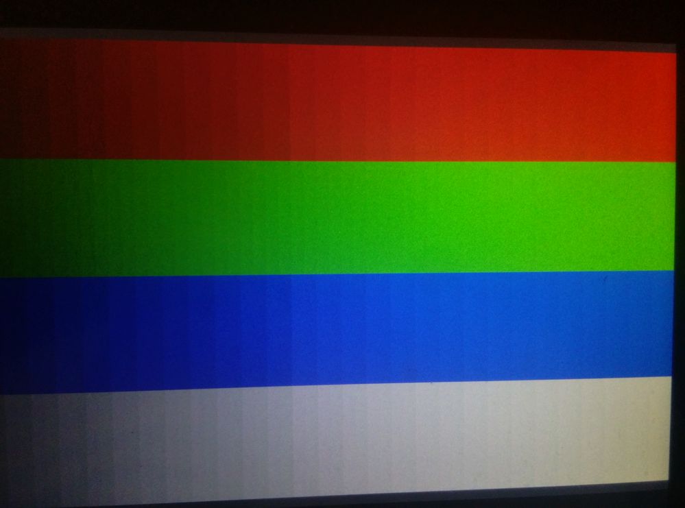

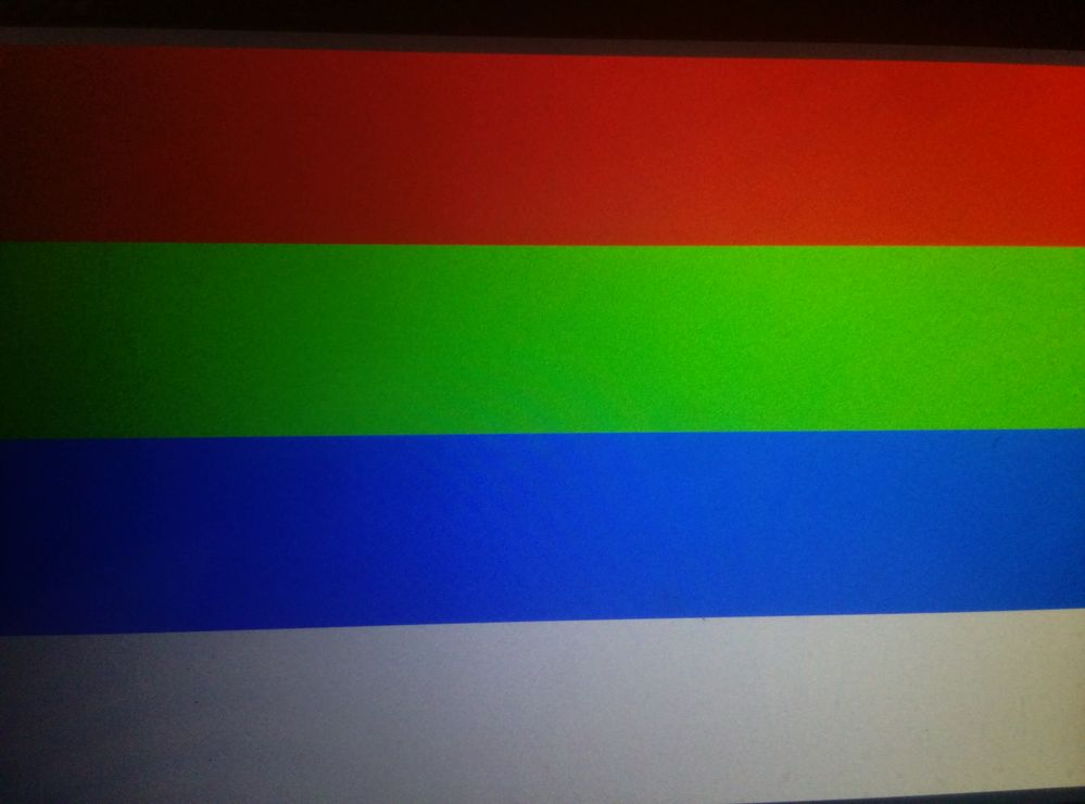

mrabe
Thanks for the support.
The overall looks are improved by disabling hw overlays. - But our customer noticed that there is a problem with certain types of fonts. However I haven't been able to reproduce this for myself by now.
Here are the pictures you asked for.
"normal operation" with Display configured as RGB666 on an 16Bit Framebuffer.
Here with disabled hw overlay:
Any ideas what might be off?
11,125 Views
SergioSolis
Hello Matthias,
It appears that the "chunks" are not identical between R G and B. R and B look to be the same and G is a bit more granular. Because of this, an immediate thought is that there is a mismatch in the RGB config somewhere, most likely the FB or the overlay. Something is likely configured for 565 rather than 666, can you check this?

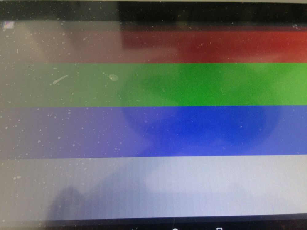

mrabe
Hi Sergio,
thanks for the response.
You are correct - Since RGB666 needs 2bit more, than a 16bit Framebuffer can offer, everything falls back to RGB565. But a 16Bit FB get dithered correctly if HW Overlay is disabled. That's why I took those example images for you.
A 24Bit/32Bit Framebuffer, that fits RGB666 doesn't get dithered, neither HW Overlay is enabled nor disabled.
I attached a picture for you, that shows RGB666 with 32Bit Framebuffer (sorry for the image quality, but you can still see the chunks),
