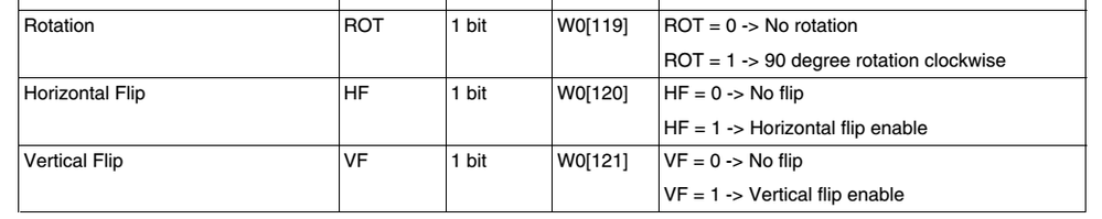

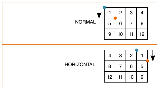

i have a question about Horizontal inversion(horizontal flip)
i know imx6's ipu has below IP block
Image converter , Image rotator
IC and IRT has a  horizontal inversion
my first question is how can i use that function of IC or IRT ?
what is best choice of IC or IRT ?
i already 120 bit set to 1 , but movie clip is not changed

vpu and ipu are different blocks, vpu is processing
only video. For vpu mirror capability one can look at attached
VPU Linux Programming Manual sect.sect.3.2.1.12 MirrorDirection.
As for ipu one can look at examples on
ipu-examples release notes - v0.1 | NXP Community
i.MX6 IPU and rotating a frame buffer | NXP Community
seems it is possible to reuse rotate example for conversion it to mirror
