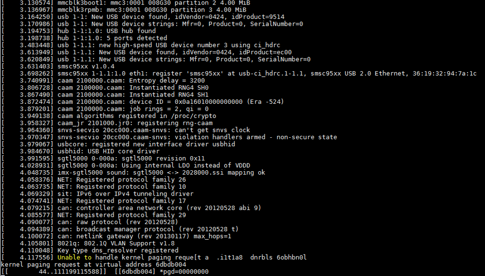

The main frequency of imx6q12ad is 1.2Ghz. When uboot starts Linux, the following contents will appear,and i can't operate Console.but I try to use imx6q10ad board, the main frequency is 1GHz, can start normally
How can I solve this problem,can anyone help me?

   Is correct dtb file used in the case?
"In standard DTB file, the LDO bypass is enabled. Therefore, to use LDO
device trees on configurations with [email protected], which does not support
LDO bypass mode, it is important to enable LDO. The LDO is enabled in the
following DTB files:
• imx6q-sabresd-ldo.dtb
• imx6qp-sabresd-ldo.dtb"
Yuri.

Thank you for your answer. I have solved this problem
