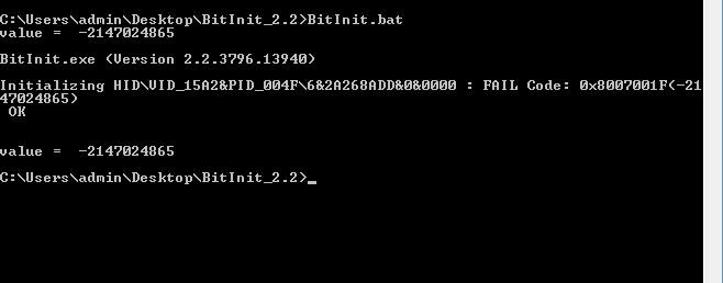

markusvalentin
Hi Yuri,
i generated a OtpInit.sb file as stated in the AN, when i try to burn the fuses via BitInit (on winxp 32,win8 32). On every platform i get the same error. What is this about?
best regards,
Markus
4,757 Views
Yuri
0x8007001F - A device attached to the system is not functioning.
Please check if the BitBurner is working on the i.MX28 EVK.
  If it works for the EVK then there is probably something wrong with the
customer's specific HW configuration. For the BitBurner operations, the i.MX28
must enter recovery mode, which can be seen as a USB human interface device in
the windows device manager.
Yuri.

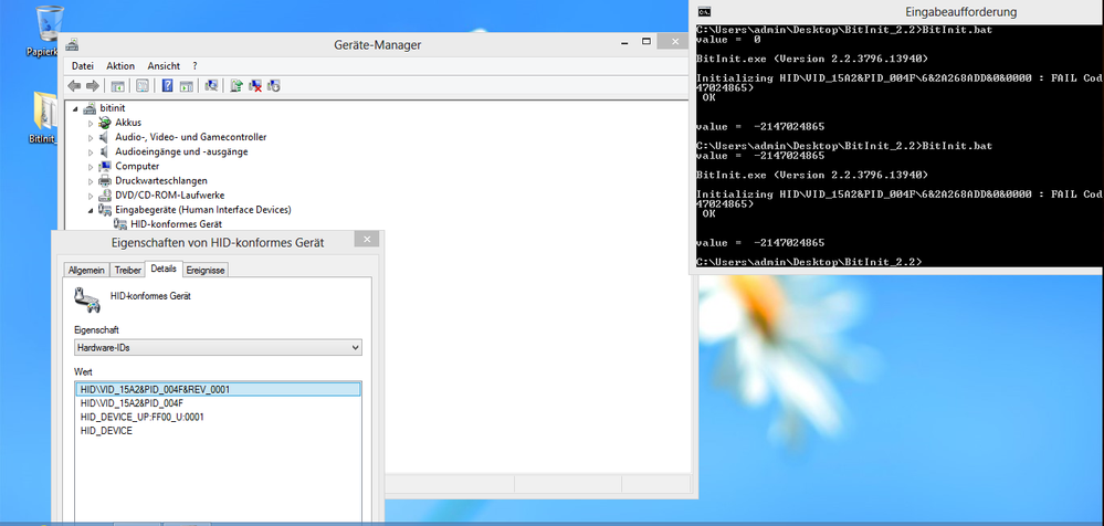

4,757 Views
markusvalentin
Thanks for the answer.
The problem is that i am already using the evk and it appears as HID Device. (as you can see in the "german" screenshot). Do you have any other hint? if not i will try to get a "new" processor on my evk.
best regards
markus
4,757 Views
Yuri
Perhaps it is OS related issue (Win 8, 10, USB3 presence).
Yuri.
