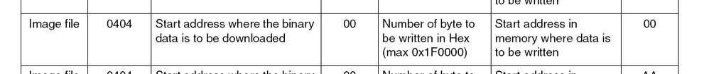

I have 2 boards, one is the imx27ads boards and another is designed by ourselves, on our own board , when I program the image file into board's flash, get the error:
Can not execute RAM Kernel
I check the atk tool source, I find when execute the Bootstrap End Indication Operation, I got the error response(0x88888808), 0x88888888 is correct.
After that I compare the 2 boards log(listen to PC serial port write/read), got the log(refer to the attachment files), I find the first difference is when execute the download command, as below
from the imx27ads board I got:
04 04 A0 00 40 00 00 00 00 BC C0 00 00 00 00 00
from our board I got:
04 04 A0 00 40 00 00 00 00 2F 30 00 00 00 00 00
I have program the same image file
All is the same but the Number of byte to be written in Hex,  I don't know why on our board the size is so small.
In code, the size is desided here:
gui_application/FlashToolDlg.cpp:
    // open image file   fp = fopen(m_strImageName, "rb");   if (!fp)   {   InsertLog(CString("Can not open image file:") + m_strImageName);   return FALSE;   }   // get file size   if (stat(m_strImageName, &fstat) != 0)   {   InsertLog(CString("Can not open image file:") + m_strImageName);   fclose(fp);   return FALSE;   }   size = fstat.st_size;   buffer = new unsigned char[size];   // read image file data to buffer   fread(buffer, 1, size, fp);   fclose(fp);
Why I program the same image file but I got the different size of file?

   Perhaps SDRAM memory on the target is not fully working. It makes sense to test memory.
The enclosed is very simple my example how to test memory via ARM block copy instructions;
code may be loaded via UART bootloader ("mx27_com_load.bat") and is running in internal
i.MX27 RAM.
  You may try adapt it for Your design.
