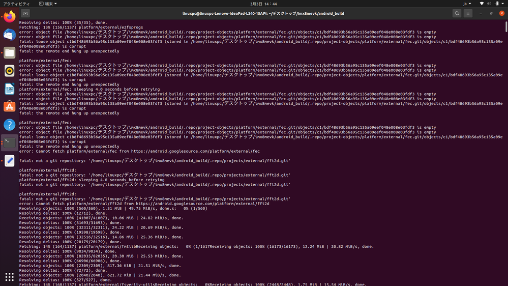

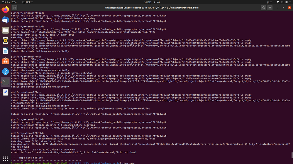

I have tried to make android 13 image for imx8 quad evk but got error while running this command -->
"source ~/デスクトップ/imx8mevk/imx-android-13.0.0_1.0.0/imx_android_setup.sh"
What I have done wrong and how to fixed it??

Hi @Ta_exa
1.Test: You can try to  use shell command to clone these code. This step is for testing the network.
2.Try to clean the project and rebuild it.
