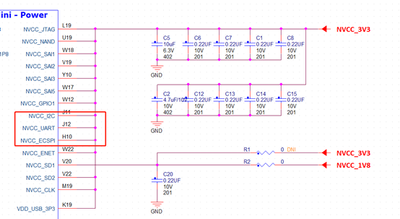

IMX 8MINI gpio POWER :NVCC-UART/NVCC-I2C/NVCC-ECSPI is set to 1.8V; Does it affect other power domains(3.3V);As shown below:
1,400 Views
igorpadykov
no. These power supplies are independent from each other.
