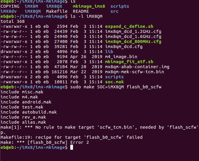

I am trying to create a bootable image for the using i.MX8 Boot process and creating a bootable image
I have an issue when trying to build using imx-mkimage
I look all over for this bin but was no able to find it

Please try re-naming System Controller Firmware binary for the target board, in your case rename the SCFW binary you already have in your folder:
mx8qm-mek-scfw-tcm.bin ------------------------------> scfw_tcm.bin
