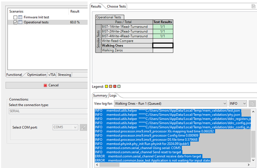

Hi NXP,
I am checking my own custom board with the i.MX95. When I ran the tests on the Config Tool, I got error message for some tests such as Walking Ones and Walking Zeros.  Please refer to the following screen shot.
It cannot receive data from target. What is the target? Any suggestion on how to fix this?
Simon

Have you choose the proper console port?

Hi @Rita_Wang ,
I think the console port is correct. The Firmware Init test and the first 3 BIST tests were passed.

Rita_Wang
Have you set the proper baud rate also?
ERROR memtool.comm.serial_channel Cannot receive data from target this mean that The tool is unable to receive data from the target board through the serial port, possibly due to issues with the serial port connection, baud rate, firmware, or power supply.
For the board are you set the boot mode to serial download mode?
