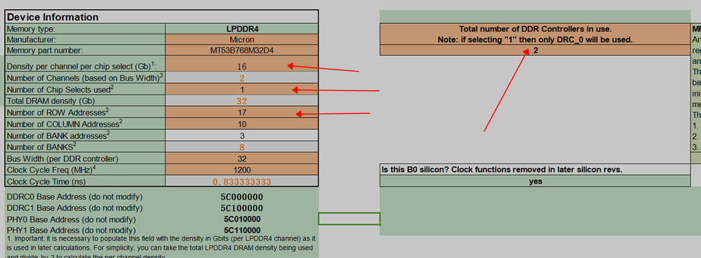

   I have a problem with a customized iMX8QM  LPDDR4 ( 2 x 4GiB ) memory.
   The table below shows memory device configuration. 16Gb per channel,1 Rank per channel .
      I configed MX8QM_B0_LPDDR4_RPA_1.6GHz_v20.xlsx file like this: Chip Selects used is 1 and Number of Row Addresses is 17.
      But it doesn't pass when i use mx8_ddr_stress_test_ER14 DDR Tester tool. Config log seems like ok, but Stress Test Blocking at  [ t0.1: data is addr test ]. The log below is all Stress Test log.

How can i do to fix this problem? or does iMX8QM platform support this LPDDR4 memory device?

Hi [email protected]‌,
Thanks for your patience, now SCFW lilmits the DDR size to 6GB both in DDR tool and Linux BSP.
1. Replace mx8qmb0_scfw_download.bin in DDR_tool/bin with the attached binary. You can stress test all 8GB memory size with your DDR script.
2. Modify board_system_config() in board.c in your SCFW project as follows
/* Board has 6GB8GB memory so fragment upper region and retain 4GB */
        BRD_ERR(rm_memreg_frag(pt_boot, &mr_temp, 0x980000000ULL, 0xA00000000ULL,
            0xFFFFFFFFFULL));
Hope this help you.
