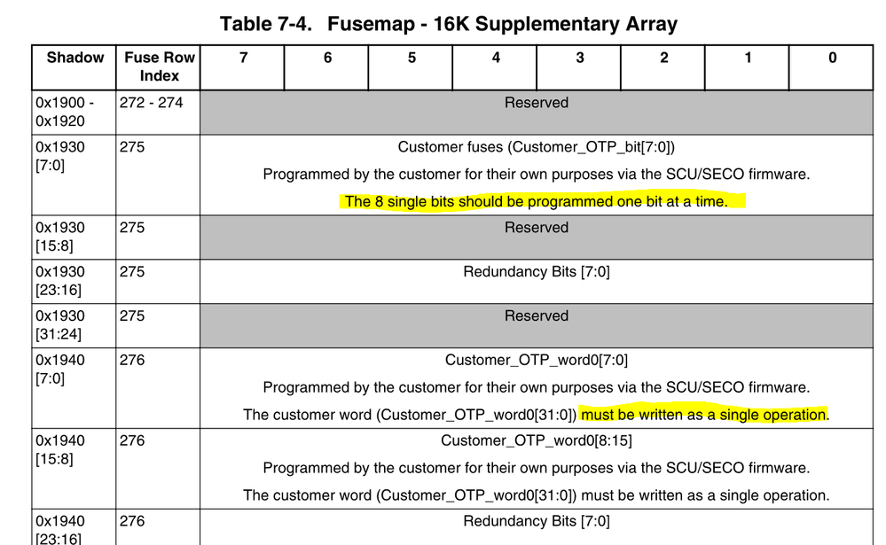

from the iMX8QM reference manual and SCU FW porting manual it is not clear:
  1. Is the programming of single-bit registers and word registers done in the same way? That is, the single bit OTP registers can be programmed multiple times?
  2. How to do shadow OTP programming? The manuals do not mention how to do that.
Thank you,
Francesco
2,133 Views
igorpadykov
Hi Francesco
in both cases fuses can not be programmed multiple times. For examples one can look at
https://imxdev.gitlab.io/tutorial/Burning_eFuses_on_i.MX8_and_i.MX8x_families/
one can look at sect.13.11 On-Chip OTP Controller (OCOTP_CTRL), that is write data
to appropriate register:
i.MX 8QuadMax Applications Processor Reference Manual
