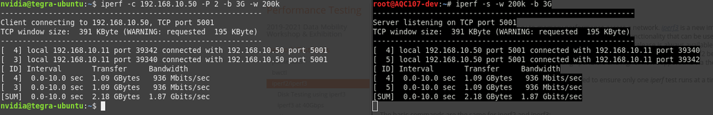

Hello Yuri,
Thanks for this advice, with iperf 2.0.10 I've succeeded to make test using TCP protocol but the maximum speed I've achieved was ~1.8Gbits/sec:

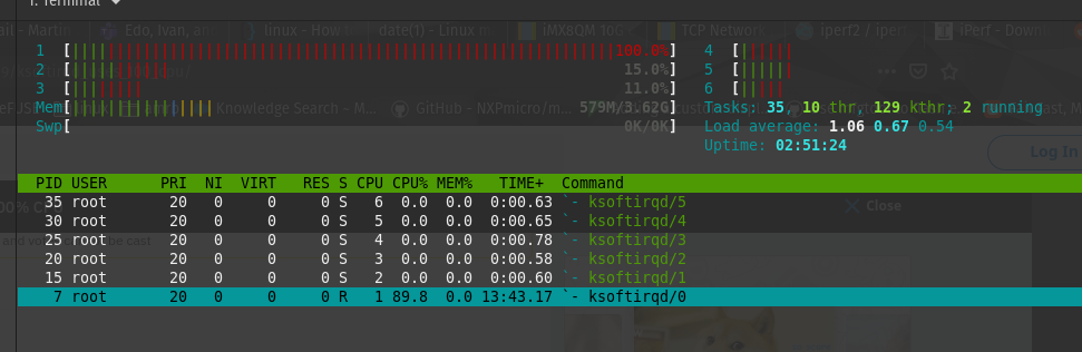

I've noticed when iperf server is handling incoming connection the ksoftirqd/0 has high CPU usage:
Is this normal behavior and could this cause issues with 10G ethernet interface?
Also, do you have any idea what could be causing the 10G ethernet interface to run at only ~1.8Gbits/sec?

  I think Your result is not so bad, taking into account i.MX8 PCie performance.
https://community.nxp.com/t5/i-MX-Processors/PCIe-Bandwidth/m-p/1063269
Yuri.

But the Gen3 PCIe x2 should be able to reach 8Gbits/sec bandwidth, Am I correct? Unless there is limitation on iMX8QM side I'm not aware of.
During the UDP test, the kernel thread "ksoftirqd/0" had high CPU usage of core 0 as well. I noticed increased UDP packet loss when I tried to run CPU intensive application during the UDP test.
Could the CPU be bottleneck for the PCIe performance? If it is, how can we solve this?
