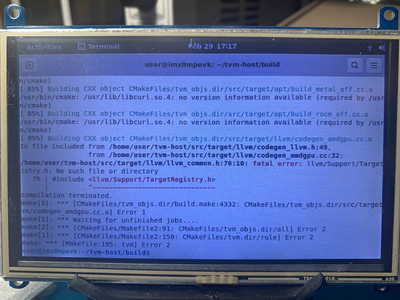

Hi all.
When assembling the example according to instructions from 6.3 How to build TVM stack on host i.MX Machine Learning User's Guide (nxp.com), an error occurs - the project is missing the TargetRegistry.h file
Any help is welcome.

It's a pity, but I still haven't found a solution - the project won't build on the imx8Mplus board...

From the log, you probably haven't followed the guide to build, as stated in guide "Follow below instructions to build TVM stack on the host and use below commands to install all dependences".

Wow! Thanks for the slow response. But, unfortunately, I followed all the steps of the assembly instructions exactly, but the "TargetRegistry.h" file never appeared in the repository. And how can it appear if you forgot to put it there?
