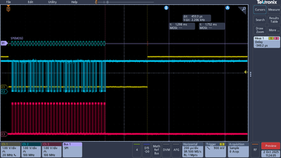

I wanted to send some bytes from this peripheral, so I used spidev_test binary for those purposes:
spidev_test -D /dev/spidev3.0 -v -s 20000000 -b 8 -p "\x11\x22\x33"
It should send 3 bytes from master at 20MHz which is working fine, from data point of view, but not the timing. If I send more bytes, the delay between last clock and deactivation the chipselect is in range of microseconds. Sometimes it's ~4us, sometimes ~500us, so it's really nondeterministic.
So it's basically unusable if you imagine, that I wanted to use 512B transfer at 120Hz, which is ~8.33ms and the delay will be ~1ms.
I was looking into driver and didn't find any place where the delay or timeout should happens. https://github.com/nxp-imx/linux-imx/blob/lf-6.6.y/drivers/spi/spi-imx.c or https://github.com/nxp-imx/linux-imx/blob/lf-6.6.y/drivers/spi/spi.c should have the delays set to 0 while is not set. How to really set the value to minimum or make it deterministic at least. Is it done by design, or there is some king of bug?

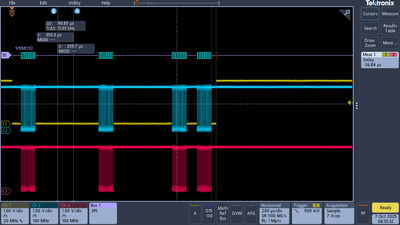

Next problem is with multi spi_ioc_transfers. If you send multiple transfers, they are "scheduled" not immediately, but sometimes there is some kind of delay between them.
Is it done by scheduler, or where/how this happen?
