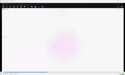

The general image pipeline seems to be up and running with this driver. There is clearly correct image data from the sensor in the resulting images. However, the image stream deteriorates quite significantly over the span of a few images. After one or two seconds there seems to only be random noise in all color channels left.
Example: video_test
./video_test -w 1920 -h 1080 -f RAW10 -t file -m 0 -d 2

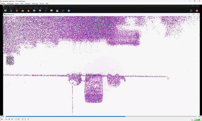

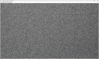

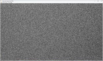

The following images show the first 4 frames obtained via video_test with the -t file output type. The original .raw files are contained in the attachments (see raws.zip).
video_test_image_1.pngvideo_test_image_1.pngvideo_test_image_2.pngvideo_test_image_2.png
video_test_image_3.pngvideo_test_image_3.pngvideo_test_image_4.pngvideo_test_image_4.png
The first image (video_test_image_1.png) does show a noisy but relatively clear image of the captured scene. The second image is already unrecognizable and from the third image onwards there is only random noise left.

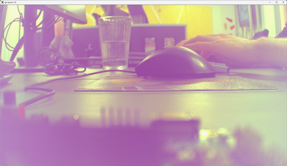

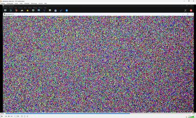

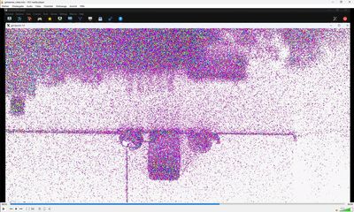

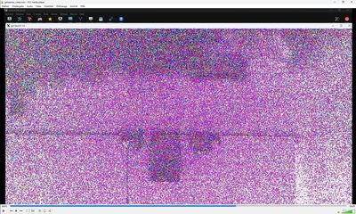

The following screenshots from the video show the deterioration frame by frame:

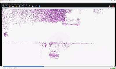

gstreamer_image_1.jpggstreamer_image_1.jpggstreamer_image_2.jpggstreamer_image_2.jpggstreamer_image_3.jpggstreamer_image_3.jpggstreamer_image_4.jpggstreamer_image_4.jpggstreamer_image_5.jpggstreamer_image_5.jpggstreamer_image_6.jpggstreamer_image_6.jpggstreamer_image_7.jpggstreamer_image_7.jpg
Theory
It appears to me that there is an issue during the debayering phase in the ISP. The sensors color information seems to not be correctly processed by the ISP.

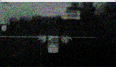

A first attempt at improving the image quality using the vvext tool proved only somewhat successful. No clear detail can be made visible, only rough outlines:
vvext settings:
  • FPS: 1
  • BLS: 0, 0, 0, 0
  • DEMOSAIC: normal
  • DPCC: enabled
  • HDR: 3, 16.0
  • DWE, AEC, AWB, AF, LSC, CPROC, GAMMA, FILTER, CAC, CNR, DPF and WDR3 disabled
After these improvements it still looks like there is something wrong with the debayering process.

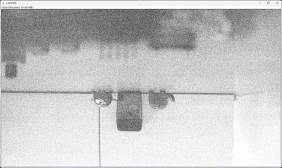

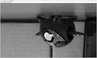

The issue must stem from a software or configuration issue, since the hardware can be proven to work. When receiving the image data using the ISI, clear and correct looking images can be obtained (see isi_reference_image.raw in raws.zip
isi_reference_image.pngisi_reference_image.pngZooming in, one can see that the image now contains the bayer pattern, since it has not been debayered by the ISP:

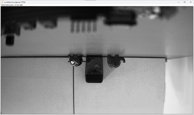

Update: I was able to solve the issue, or at least identify it. The issue was the ISP trying to set the exposure and gain. Once I disabled it (comment out IOCTLs VVSENSORIOC_S_EXP, VVSENSORIOC_S_VSEXP, VVSENSORIOC_S_GAIN and VVSENSORIOC_S_VSGAIN) I received proper images via gstreamer:
I assume the calibration data in the .xml specifies a target value for the image quality (e.g. contrast level or median brightness). The ISP then presumably tries to optimze the image towards this target state using exposure and gain.
However I do not yet have proper calibration data for the IMX327 sensor. The calibration data I used was copied over from the IMX219 example of AN13963. Therefore the target value probably does not make sense for the IMX327 sensor.
The ISP then tries to reach an unreachable state via the setting of exposure and gain making the image quality and noise level increasingly worse.
Of course the proper fix for this problem is to produce/obtain sensor specific calibration data. That way the target state fits the IMX327 sensor.

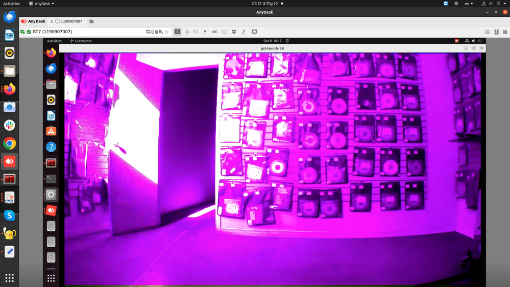

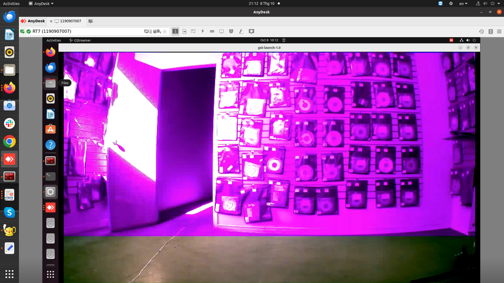

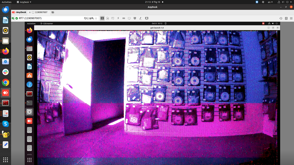

I got following color issue with the 2nd camera pipeline, even if it was the only launched pipeline :
Screenshot from 2024-10-08 21-13-00.pngScreenshot from 2024-10-08 21-12-49.pngScreenshot from 2024-10-08 21-12-43.png

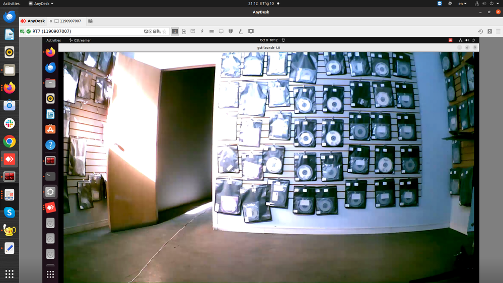

The good image (from the fist pipeline) should be as below :
Have you ever noticed similar issue? Knowing that we are using the LF6.1.36-2.1.0 release.
Thanks and best regards,
