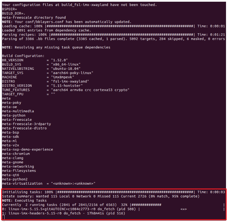

Hi. I am asking for help because I have a problem.
I am proceeding with 3.1 Docker of 3. Host setup of i.MX Yocto Project User's Guide.
An error such as the photo below occurred while performing bitbake imx-image-core.스크린샷, 2022-04-28 09-17-50.png스크린샷, 2022-04-28 09-17-50.pngThe work of 0:, 1: in the picture above never ends.
I've tried it again many times, but the results are the same.
What's the problem? Please help me.

Please try to change URL in the recipe
From
KERNEL_SRC ?= "git://portland.source.codeauxxxxxxxxxxxxxxxxxxxx
To
KERNEL_SRC ?= "git://source.codeauxxxxxxxxxxxxxxx
And try again

WolsYang
I have the same problem.
I think there had some issue on the remote server.

Is imx-image-core the recipe?
Please tell me the location of the imx-image-core.
3,956 Views
WolsYang
You need to find yourself,
For example, if you are stuck at linux_imx do_fetch, probably the recipe is name linux-imx_xxxx.bb
And go find the SRC_URI change.

jihoon-shin
Thanks!!!! @WolsYang
I solved the problem!

WolsYang
Not yet, still stock at do_fetch.
I think should wait for NXP to check codeaurora connection.
