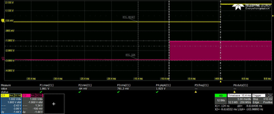

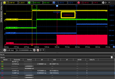

Dear Team,
Regarding the iMX8MN specifications, only typical and maximum values are provided, but there is no minimum value given.
Our measurement result is -9.54ms. Does this meet the iMX8MN power sequence requirement?
Please advise.

Bio_TICFSL
Check the MX8Nano Power Consumption document:
https://www.nxp.com/docs/en/application-note/AN12778.pdf
But that value is correct and must pass, the minimum is 0.1uS

justin_hsieh
Hello sir,
We have verified the RTC timing on the 8MNANOD3L EVK, and the test results show a timing of approximately -9.5 milliseconds, which matches our device's test results. Based on this test result, it appears that the EVK does not meet the requirement.
Please advise.
