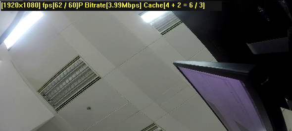

    1.Do not add imxvideoconvert_g2d element, direct transmission after encoding
Enter command:
./test-launch  -p 554  "v4l2src  device=/dev/video0 ! video/x-raw,format=UYVY,width=1920,height=1080 ! queue !  vpuenc_h264 bitrate=4096 ! rtph264pay name=pay0 pt=96"
Test results:
It is normal that the input source is 60fps and it is still 60fps after transmission

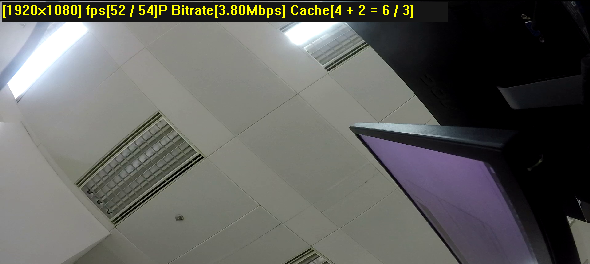

    2.Add imxvideoconvert_g2d element, transmission after encoding
Enter command:
./test-launch  -p 554  "v4l2src  device=/dev/video0 ! video/x-raw,format=UYVY,width=1920,height=1080 ! queue ! imxvideoconvert_g2d ! video/x-raw,width=1920,height=1080 ! videorate ! video/x-raw,framerate=(fraction)60/1 ! vpuenc_h264 bitrate=4096 ! rtph264pay name=pay0 pt=96"
Test results:
The input source is 60fps. After transmission, it becomes 52 ~ 54fps, so the frame is lost. Moreover, the 4m code rate was originally set, but the player displays only about 3.8m code rate.

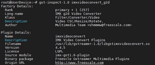

My current imxvideoconvert_g2d element version:
My current videorate element version:

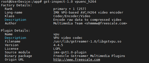

My current vpuenc_h264 element version:
My question:
  1. How to solve the problem of losing frame rate after adding imxvideoconvert_g2d element without adding additional delay?
  2. Can replacing imxvideoconvert_g2d element with the latest version solve this problem? If yes, please provide the corresponding version number?
  3. I found that this problem only exists at 1080p and 60fps. Can the hardware performance only reach this level and cannot be optimized?

igorpadykov
Hi Peng
L4.14.98_2.0.0 is old release, may be recommended to try with latest L5.10.52_2.1.0
and imx-gst1.0-plugin version
https://source.codeaurora.org/external/imx/imx-gst1.0-plugin/tree/?h=MM_04.06.03_2110_L5.10.y
https://www.nxp.com/design/software/embedded-software/i-mx-software/embedded-linux-for-i-mx-applicat...
igor
