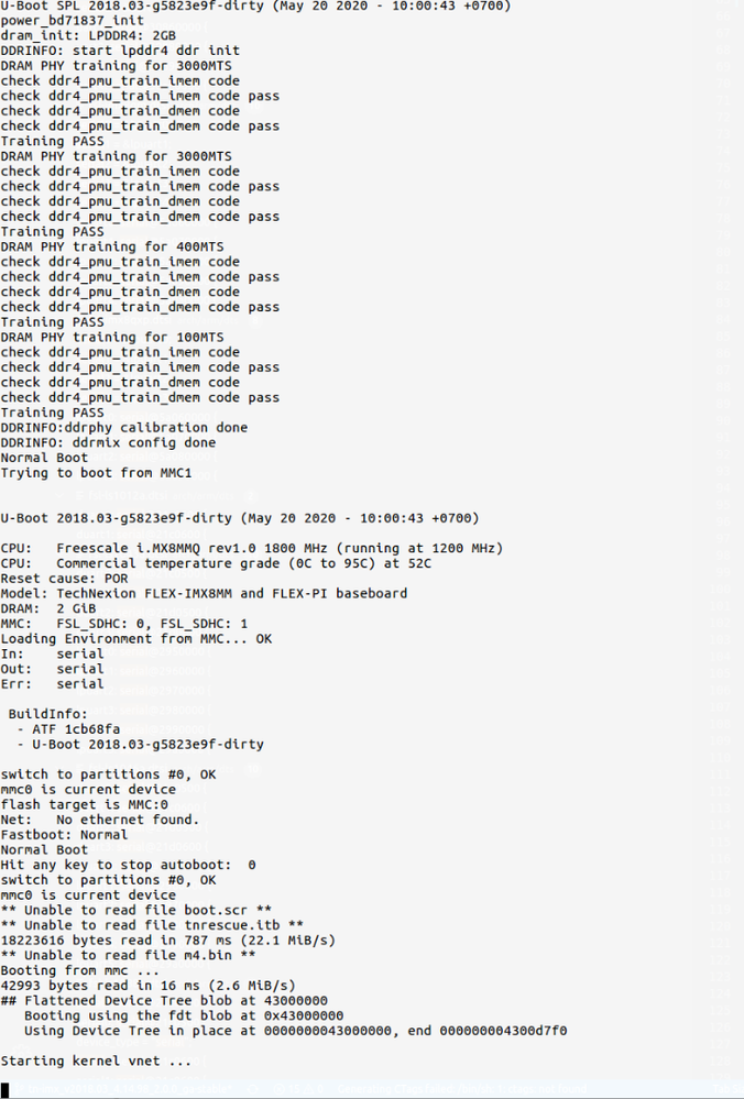

Hello
I'm using flex-imx8mm
I want to change console from UART 2 -> UART 3. I changed it in the u-boot, but I can't start kernel.
Please help me. Thanks you
[UPDATE]
Change 0x30890000 to 0x30880000
"console=ttymxc2,115200 earlycon=ec_imx6q,0x30880000,115200\0" \

Result:
U-Boot SPL 2018.03-g5823e9f-dirty (May 19 2020 - 14:45:59 +0700)

Starting kernel ...

Hi [email protected]‌,
Are you using the Yocto build system to generate the images?
If so then, you also need to change the value of the "SERIAL_CONSOLES" variable in the machine configuration file in yocto build. You need to assign ttymxc2 to the SERIAL_CONSOLES variable as well.
e.g. SERIAL_CONSOLES = "115200;ttymxc2"
Hope this will help you.
Shivani
9,724 Views

Thanks for response.
I tried it, but it didn't show in the uart3 (ttymxc2)

joanxie
from dtb, uart3 should be tty2,
 serial0 = &uart1;
  serial1 = &uart2;
  serial2 = &uart3;
  serial3 = &uart4;
test   /dev/ttymxc2 with cmd:
/unit_test/UART/mxc_uart_xmit_test.out /dev/ttymxc2  -B 9600
9,724 Views
kat61545
Thanks, but I do not understand your answer
flex-imx8mm.h
line 156: Modify
"console=ttymxc1,115200 earlycon=ec_imx6q,0x30890000,115200\0" \
"console=ttymxc2,115200 earlycon=ec_imx6q,0x30890000,115200\0" \
line 279: Modify
#define CONFIG_MXC_UART_BASE UART2_BASE_ADDR
#define CONFIG_MXC_UART_BASE UART3_BASE_ADDR
flex-imx8mm.c
line 45: Add
static iomux_v3_cfg_t const uart_pads3[] = {
IMX8MM_PAD_ECSPI1_SCLK_UART3_RX | MUX_PAD_CTRL(UART_PAD_CTRL),
IMX8MM_PAD_ECSPI1_MOSI_UART3_TX | MUX_PAD_CTRL(UART_PAD_CTRL),
line 58: Modify
imx_iomux_v3_setup_multiple_pads(uart_pads, ARRAY_SIZE(uart_pads));
imx_iomux_v3_setup_multiple_pads(uart_pads3, ARRAY_SIZE(uart_pads3));
imx8mm-flex.dtsi
line 25: Modify
bootargs = "console=ttymxc1,115200 earlycon=ec_imx6q,0x30890000,115200";
stdout-path = &uart2;
bootargs = "console=ttymxc2,115200 earlycon=ec_imx6q,0x30890000,115200";
stdout-path = &uart3;
This is my change. I stuck at "Starting kernel ..."
