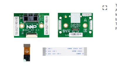

joanxie
I don't think we have tested this driver(ar1335_mipi_v3.c) since current nxp imx8mp board doesn't support ar1335 as default, but I found internal team tested ar1335 on nxp converter board, but I couldn't share the patches here, if you need it, let me check how you can get it
