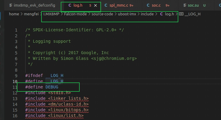

mengfei
Dear:
I’m implementing Falcon Mode using NXP’s app note AN13709. now i successful achieve spl jump to kernel but have below error messenge. can you read it and tell me how to deal?
my best wishes for you
 mf

spl_start_uboot retval :0 1:set define fault
load FDT file to RAM
hdr read sector ebf584, count=1
entry mmc_load_legacy function
SPL: payload image:                     Linux kernel load addr: 0x4047ffc0 size: 28013120
read d5ba sectors from 0xebf584 to 0x4047ffc0
ATF:read 0x60 sectors from 0xECDF80 to 0x970000
FDT-args:read 3d sectors from ebf520 to 43000000
Jumping to atf then linux

I use lf-5.10.72-2.2.0 version.Now the log is below(too much messenges is because #define DEBUG)
to be honest,i feel that compared to 5.10.72, 5.4.70 is better
