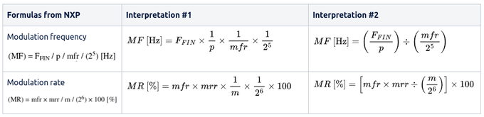

The spread spectrum mode parameters of all i.MX8M Mini PLLs that have this functionality can be calculated using the formulas below.
1. The modulation frequency can be calculated as:
MF = Fin / p / mfr / (2^5) [Hz]
where:
Fin - the input reference frequency (typically, 24MHz = 24 * (10^6)Hz);
p = CCM_ANALOG_XXX_YYY_FDIV_CTL0[PLL_PRE_DIV] - reference frequency pre-divider value;
mfr = CCM_ANALOG_XXX_YYY_SSCG_CTRL[PLL_MFREQ_CTL] - modulation frequency factor.
2. The modulation range can be calculated as:
MR = mfr * mrr / m / (2^6) * 100 [% percentage of the PLL output frequency]
where:
mfr = CCM_ANALOG_XXX_YYY_SSCG_CTRL[PLL_MFREQ_CTL] - modulation frequency factor;
mrr = CCM_ANALOG_XXX_YYY_SSCG_CTRL[PLL_MRAT_CTL] - modulation range factor;
m = CCM_ANALOG_XXX_YYY_FDIV_CTL0[PLL_MAIN_DIV] - PLL main divider value.

henriquebg
Hi @art !
The way the formulas are written in the Reference Manual is a bit ambiguous.
Could you please confirm which of the interpretations below are correct for the spread spectrum formula?
Or, if none of the interpretations are correct, please let me know the correct interpretation.
Also, could you please point out the recommended "place" to enable the spread spectrum?
Maybe inside fracpll_configure?
https://source.codeaurora.org/external/imx/uboot-imx/tree/arch/arm/mach-imx/imx8m/clock_imx8mm.c?h=i...
Henrique
