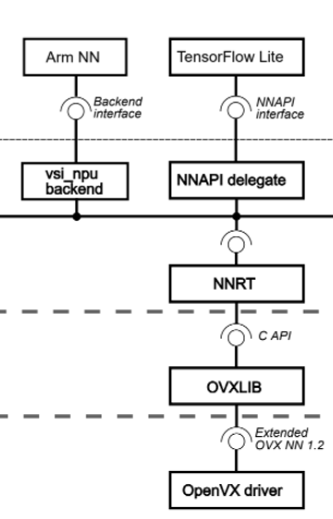

Making inferences with the said .tflite model by using (ArmNN + vsi_npu) instead of (TFLite + NNAPI) gives exactly the same (wrong) results.
This certainly means that there is a problem in the bottom blocks: NNRT or OVXLIB or OpenVX or Hardware.

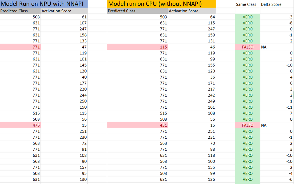

As per page 12 of this manual dated 31 March 2021, https://www.nxp.com/docs/en/user-guide/IMX-MACHINE-LEARNING-UG.pdf
you can easily benchmark mobilenet_v1_1.0_224_quant.tflite on CPU and on NPU (--use_nnapi=true)
These are the result of inference:
The CPU activations are the "correct" ones, obtained by algebraically doing the calculations on any other computing platform for the same input image. This means that some approx is introduced by NNAPI delagation or NPU itself. Considering that this is an already quantized model, this is not good.
