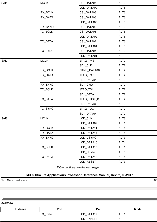

I'm going to design iMX7ulp based Hi-Fi audio device, but there is no free SAI on iMX7ulp EVK board. Moreover, I can't find information in iMX7ulp reference manual about what pin can I reassign to provide SAI pins out.
I can't find a table like it was in iMX6ul reference manual:
How can I use SAI on iMX7ulp EVK board? What pins can I reassign? Where is the table of pins mux like it was in iMX6ul datasheet?

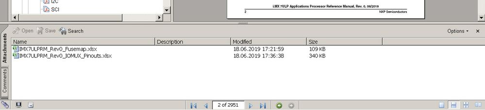

The IOMUXC Spreadsheet is mentioned several times in the reference manual but I'm not able to find the attachement.
Can you please provide a link to the spreadsheet?
Thanks!
2,582 Views
igorpadykov
Hi Vladislav
open with pdf viewer reference manual and look at "attachment" tab
i.MX 7ULP Applications Processor Reference Manual
igor
2,582 Views
nikjedrzejewski
Take a look at the attachments in the Reference Manual.  You'll find the PinMux there.
