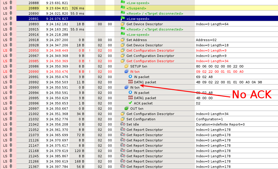

Please find screenshot from USB analyzer:
The most _strange_ issue here is the lack of _any_ error indicated by the HOST driver. All transmissions end
with USBINT set. No error interrupt present. This corrupted data (with smaller size than expected) is then
passed to upper layers, causing subtle errors.
Please find below some data dump from EHCI's qTD (Queue Element Transfer Descriptor):

What you see in the trace is that the host controller starts an IN transaction to which the device replies with an 8-byte packet with DATA1 data toggle. The Host does not ACK the packet, which means that it saw an error (CRC or other). The host starts a new IN transaction (this is an automatic retry) to which the device responds with DATA1 toggle, but a zero length packet. This is an incorrect response from the device. It should have sent the previous packet again because it dd=id not receive an ACK. The device stared correctly by sending DATA1 toggle, indicating it was repeating the packet, but instead of repeating, it sends ZLP, which means that the transaction is completed. The host ACK's the ZLP and will not try to read more data.
When the host received the ZLP, the CERR counter was also restored to 3 since CERR must be restored when a packet is received correctly from the given endpoint (or by the endpoint in case of OUT transactions).
Regarding the urb and qTD, please note that the qHead overlay area is the workspace for the controller. The qTD will only be updated with the qHead data after the transaction is completed. So for that specific IN transaction I expect the XactErr bit to be set in the status of the qTD.
[ 1.988809] qh_completions: urb token 0x920d08 0 178     <- here we do have still active "status" 9x8
In the log entry above is an IN transaction, but it is not yet completed (active bit is set) and thus the status is not yet updated.
I hope this clarifies the issue.
