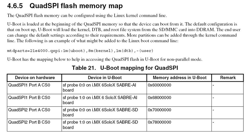

suggest to test sf probe 0:0
and read attached Linux Guide sect.4.6.5 QuadSPI flash memory map,
sect.4.7.4 Running the Linux image from QuadSPI
igor

=> sf probe 0:0;
SF: Unsupported flash IDs: manuf 00, jedec 0000, ext_jedec 0000
Failed to initialize SPI flash at 0:0
=> sf probe 1:0;
SF: Detected N25Q256 with page size 256 Bytes, erase size 4 KiB, total 32 MiB
Which is an expected result as the flash is connected to QSPI2 on imx6sx sdb. But it doesn't work when I flash the stuff you provided to the right locations :-(

igorpadykov
Hi Matthias
for "sf probe" please look below (part of Linux Guide)
Please try attached uboot, flash it on SD card.
I tested on my i.MX6SX SABRESDB rev.A (with qspi-nor-spansion-s25fl128s) and it worked.
