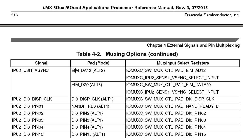

are the "Parallel Display Data Oriented Interface" signals (DIx_PIN11..15, DIx_CS0/1) of IPU2 available?  iMX6 Quad Reference Manual lists them only for IPU1.

you are right, for IPU2 only PIN15 is available
