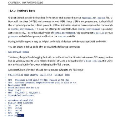

inayathraza
Hi igor, Thanks for Reply
I am working on the IMX6DL sabresd board, Is there any way to enable USB, in Release Note its, mentioned as the USB stack is not enabled in
UEFI by default, How we can enable this in our FFU?

igorpadykov
are you able to see below (from p.61 i.MX Windows 10 IoT Core User’s Guide​)
for connection usb stick to usb otg, signal usb_id (pin4 J505 SPF-27417) should be low.
igor
