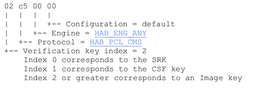

Are you using uuu or imxusb to boot over USB? AFAIK uuu needs no other manipulations, just running cst with csf file containing additional Blocks= record for DCD in SRAM. imxusb additionally requires signing image with cleared DCD pointer in IVT. You HAB event 2 seems mentioning SRAM area @ 910000

Looking to this HAB Event 2 I figured out that the problem is with key with index 2.
--------- HAB Event 2 -----------------
event data:
0xdb 0x00 0x24 0x42 0x33 0x18 0xc0 0x00
0xca 0x00 0x1c 0x00 0x02 0xc5 0x00 0x00
0x00 0x00 0x13 0x40 0x17 0x7f 0xf4 0x00
0x00 0x06 0x7c 0x00 0x00 0x91 0x00 0x00
0x00 0x00 0x03 0x18
Cause according to HAB4 RM the first byte of the 4-th word contains key index.
That's why I assume that here we have successfully passed SRK table verification, CSF key installation, IMG key installation, CSF verification and failed during [Authenticate Data] command.
But I still can't understand where is the mistake:(
