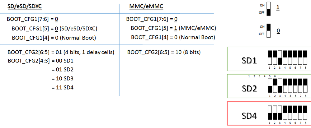

A custom board with a iMX6 DualLite have the BOOT_MODE equal to "10" (Internal Boot) and the boot flow is controlled by GPIO as below:
The board have three SD sockets (SD1, SD2 and SD4). The following options are used to select the device:
For testing purpose, I check the value of the register SBMR1 and SBMR2 in uBoot  as below:

The testing shows unexpected results because the BOOT_CFG2 (in SBMR1) always have the bits [6 to 4] in zero and only recognize the bit [7] from the GPIO configuration (or dip switch).

For example, the values of registers SBMR1, SBMR2, GPIO and FUSES, when all the dip-switch are set to use SD1 (BOOT_CFG1[7:4] = 0000, BOOT_CFG2[6:3] = 0100) are (please, refer to text in red color for unexpected results):

I did another test to validate all the GPIO, when all the dip-switch are set to "1" (please, refer to text in red color for unexpected results):

In conclusion, the bits BOOT_CFG1[6], BOOT_CFG1[5], BOOT_CFG1[4] are not changing according with the GPIO configuration or dip-switch.
Any suggestion?

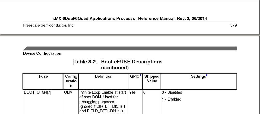

igorpadykov
HI Julio
suggest to check SBMR with jtag debugger, setting
BOOT_CFG4[7]=1, this is most accurate way.
Note, SBMR latches data on POR deassertion so
after booting, setting boot pins and reading them in Uboot
may lead to not correct results.
igor

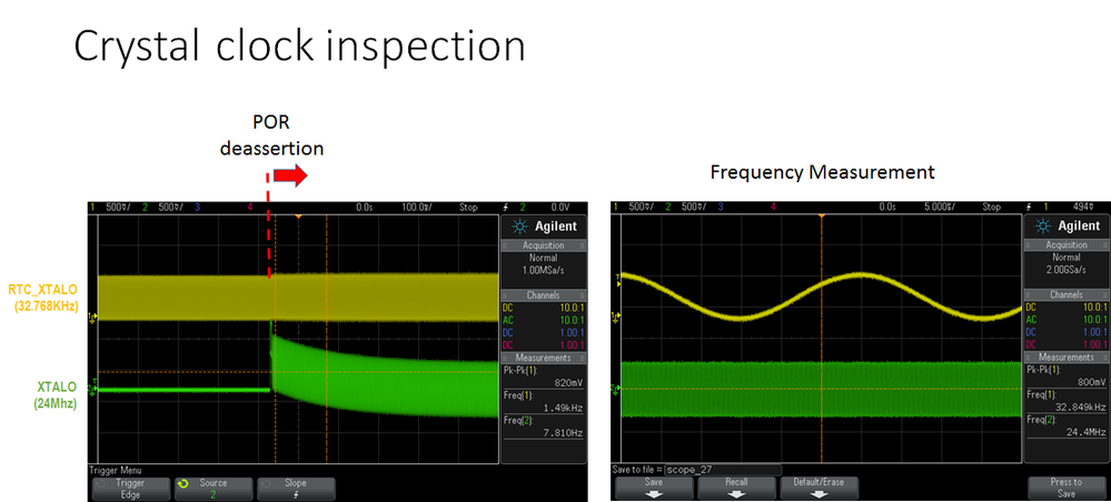

juliocruz
Hi Igor,
I follow your suggestions.
  1. The POR is prolong for 1 sec. The results seems be the same. Only can change the bit BOOT_CFG2[7] and the others [6, 5, 4] don't change at all.
  2. The crystal clocks were  measured. The scope shows 32KHz and 24Mhz after POR.

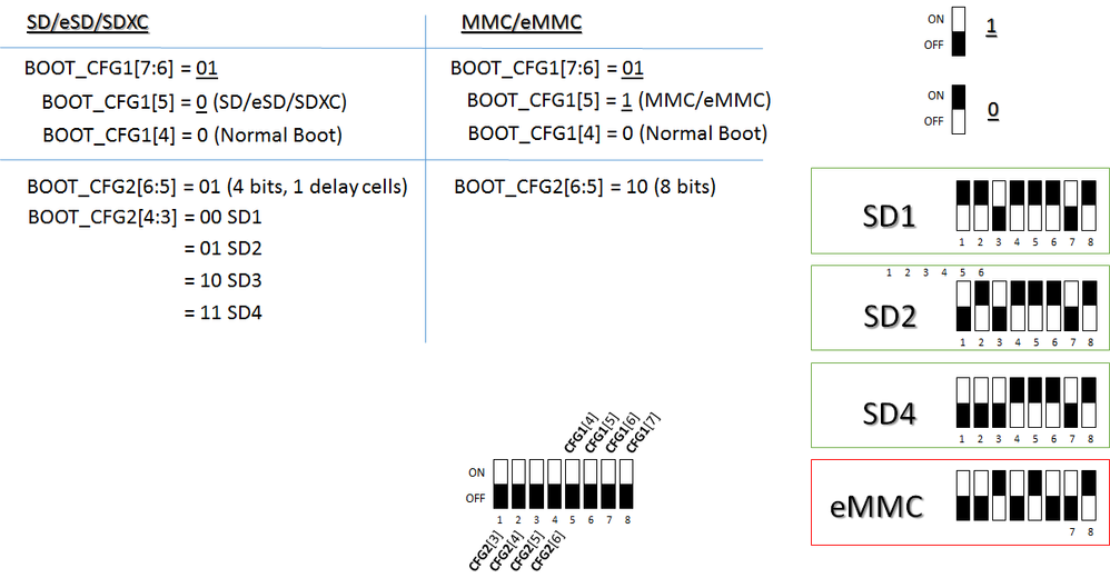

Dear Igor, all,
I found where the problem was.
  1. When the SBMR is read, the "bit shift" operation was incorrect and the values on BOOT_CFG2 was shifted. Now, I fix the shift operation and everithing is as expected.
  2. Additionally, the BOOT_CFG2[7:6] must be in "01" for SD (1, 2, 3, or 4) and MMC/eMMC. Previously, this value was always in "00".
In conclusion, the SBMR1 is returning the correct values after reset and the SD is booting according with the GPIO config (SD1, SD2 and SD4).
Below, the code used to read the SBMR1 and configuration used on this board.
